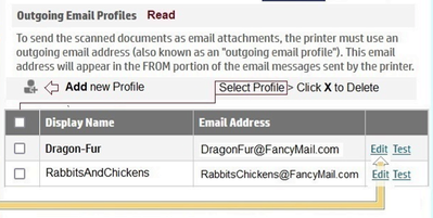

I think you are perhaps cross referencing (mixing?) elements that you are reading and possibly seeing -- it is entirely possible that the idea of more than one email address might have come from reading about Scan to Email.
The Pro Plus and Pro Premium models support "Scan to Email" --
Scan to Email this is not ePrint.
Scan to Email is a method that (when and where supported) can be used to scan from the printer using a Scan to Email Profile (sender's setup).  It is possible to have more than one Scan to Email (sender's) Profile.
IF you you have somehow tangled up in EWS - Digital Send > Scan to Email, that is a another different animal.
Partial sample - More than one Profile in Scan to Email that supports SMTP Digital Sending
