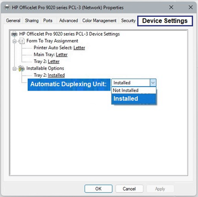

Tray / Duplex feature installed? (Model Dependent)
Windows 10
Control Panel > icon view > Devices and Printers
Right-Click Printer > Printer Properties > Tab Device Settings
OR
Windows 11
Settings > Bluetooth & devices > Printers & scanners
Select Printer > Printer Properties > Tab Device Settings
OR
Next,
Under Installable Options
Automatic Duplexing Unit > Select / Verify Installed > OK
And
Tray # = Installed
