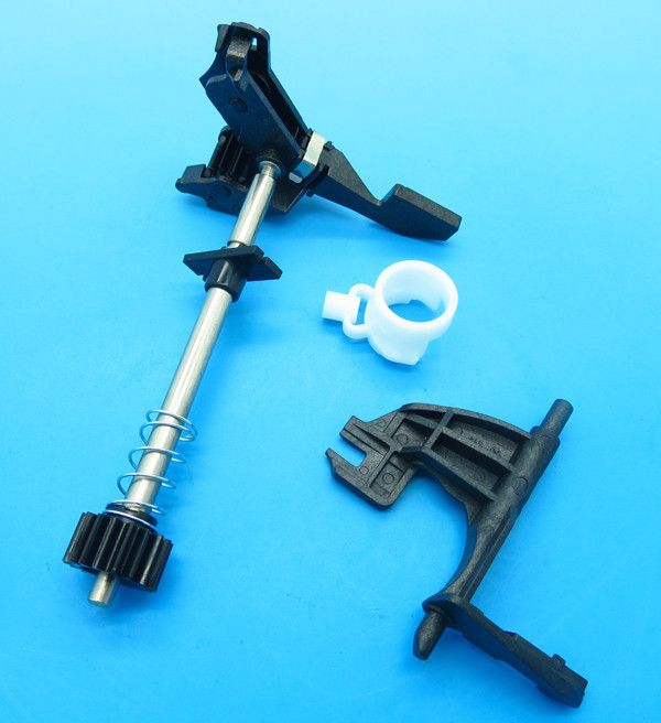

I have exactly the same problem with a similar printer from the same series, Officejet J6410 aka CB029A. The 15 tooth, 14-15 mm diameter spur gear that was press-fitted on the 4 mm diameter clutch shaft did not bear up the workload and got cracked, so the black clutch gearbox became unattached and fell off. Since the clutch actuates the paper feed drive when the printer head is parked all the way to the right, without this gear the paper feed is impaired thus triggering the paper jam sensors.
The clutch assembly gearbox has only 2 gears, the small plastic 'shaft' acts only as a spacer.
If you have the ability to fabricate a cut/molded replica in brass/epoxy/plexiglas, a zoomed-out photo is below - consider the shadows, the slight larger dimensions due to the crack, and that the bore diameter is 4 mm to fit the shaft. The grid is 5 mm.
HP OfficeJet J6410 15t spittoon clutch gear
A replacement that looks identical could be "Clutch Gear Set for HP 7000 Officejet". A Google search will point to a large Chinese online shop where you can purchase a replacement for under US$8 plus shipping (aliexpress.com/item/Clutch-Gear-Set-for-HP-7000-Officejet-printer-spare-parts/2021088520.html). The advantage of replacing the entire clutch assembly is that the gear comes factory press-fitted, which should fix the problem and extend your printer's life.
banthony, a replacement that looks identical could be "Clutch Gear Set for HP 7000 Officejet" and is currently available at a large Chinese online shop for under US$8 plus shipping (aliexpress.com/item/Clutch-Gear-Set-for-HP-7000-Officejet-printer-spare-parts/2021088520.html).
http://www.aliexpress.com/item/Spare-Parts-for-HP-7000-Fuser-Gear/32628539729.html
This seems to be the part you are looking for. It is called a fuser gear. I've ordered the clutch gear set for my J6480. This just seems to be the gear...not sure if it is the entire assembly of the part that was loose in your video, or if it is actually just a gear.
