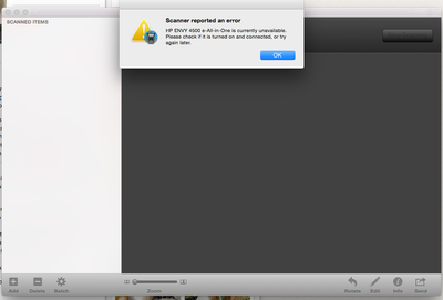

I can make copies and I know the scanner works because I can scan to my iPad thru the AiO Remote app from hp. I don't have the USB cable, I guess that I lost it because I have never use it before. I tried to scan from my mac using system preferences, image capture and preview and I got this message.

I tried power cycling the network devices and I also reset the network in the printer but nothing works.
