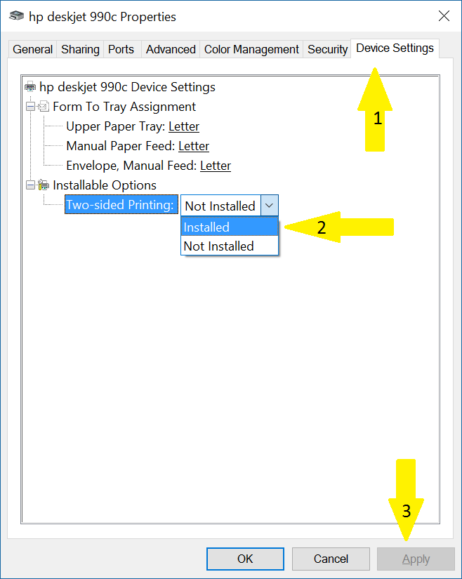

Once the driver is installed you may need to enable the duplexer. Right click on the Deskjet 990c, select Printer Properties and enable the duplexer.
