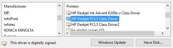

Firstly, I thank you for your reply.
I have tried what you say:
1. HP Deskjet PCL3 Class Driver
2. Photosmart PCL3 class Driver
3. Officejet PCL3 Class Driver
4. Deskjet 990c
5. Deskjet 450 driver
There weren't the drivers at 4th and 5th row. They have appeared after Windows Update process at that window.
Installing the New Driver
The Situation at Devices and Printers
Printing on Word 2010
But, the printer is not reacting/printing for any driver. It is waiting only. The printing window says "pending" and then it stays empty.
