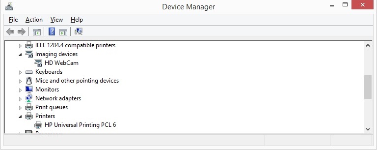

I have 2 machines:  Windows 8.1 64 bit and Windows 8 32 bit.  The former is the one which will connect to the 3052 by USB.  The driver installs automatically when connected by USB, and shows as follows on the 64 bit machine.  Note nothing is shown under Imaging Devices (whereas on the 32 bit machine it does).
NB.  I can get the 3052 to print over network and USB.

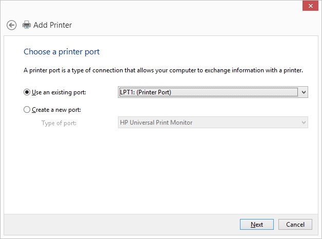

OK.  So following your instructions, I get as follows:

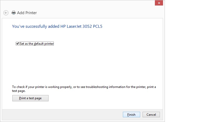

Selecting this driver, clicking Windows Update and then Installing the Driver as follows:
Successfully installed...

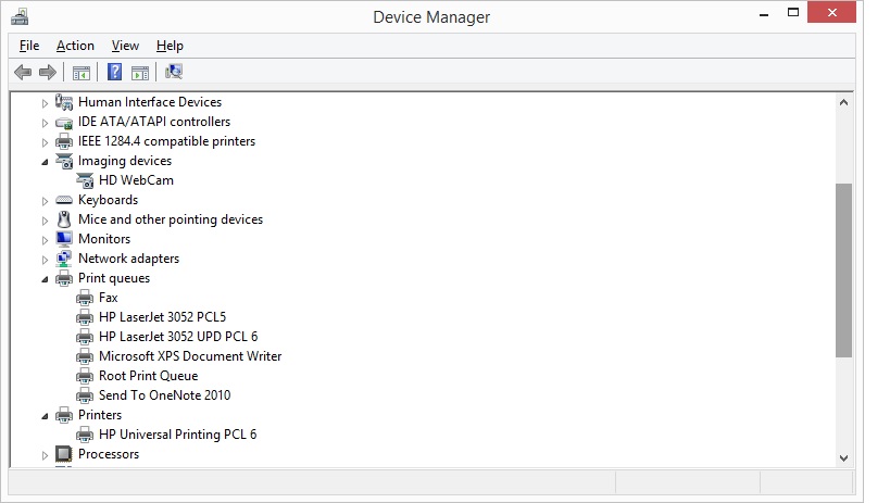

Device Manager - not looking promising under Imaging....
