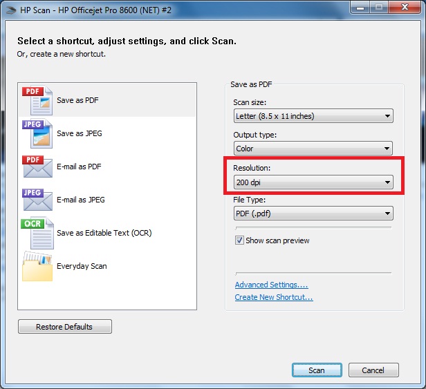

Open the Icon labeled Officjet Pro 8600 on your desktop, and then click on Scan a Document or Photo. When the Scan application window opens you can change the Resolution from the drop down menu.
I hope this helps.

I'm trying to change the preset resolution from 200 dpi to 300 dpi. I have read these forums and when I click on the Officejet 8600 pro on my computer it just brings up the area to scan. I cannot readust the dpi. I want to attach a screen shot of the screen I get, b/c I cannot figure out how to do that.
Please help!

If you take a look at Boston_RDSX post above, you will see an example of the HP scan box.
