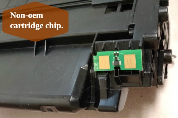

I tried a brand-new oem HP cartridge (Q6511x). I had to break the plastic tab and pull out the plastic "ribbon". I also moved the chip from the (nearly spent) non-oem cartridge that has consistently worked, to the oem cartridge. This made no difference--the new oem cartridge still didn't work. I had previously unsuccessfully tried several cartridges, including a new non-oem MICR cartridge. Just by visually inspecting the non-oem and oem cartridges, I'm baffled why one worked and the other didn't. The cartridges appear practically identical structurally. As previously stated, I observed several installed cartridges with the left cover removed and the grounding contact appeared to make a solid connection with each cartridge.

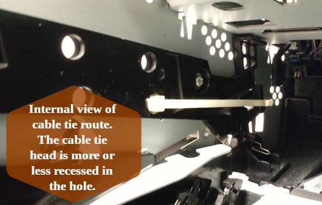

After implementing a cable tie fix, I tested the new oem cartridge with it's original chip, successfully. I used quantity 3, "daisy-chained" cable ties. For anyone else experiencing similar/identical symptoms, I make no guarantee that this is the best way to implement a cable tie fix or that this will resolve the problem(s) you're experiencing. But hopefully someone finds this helpful. See pics below.

Very nice post, thanks for sharing your discoveries with us.
> Any ideas what might cause this and what is a good next step for troubleshooting or eliminating certain problem sources?
Printer design.  Sometimes parts are designed in a way that they can naturally seperate overtime or from repeated cartridge replacement.  Adding a quick fix with a cable tie is an easy repair that will alleviate those problems as you have documented.  These are fairly common on other printers too but usually is more of a problem on the cartridge as opposed to the printer.
Hi John,
Thank you for the response. Do you have any photos of what this should look like, or can you provide a detailed description? I can experiment with it, but I wasn't quite sure what specifically should be cable tied to the chassis.
Thank you!
