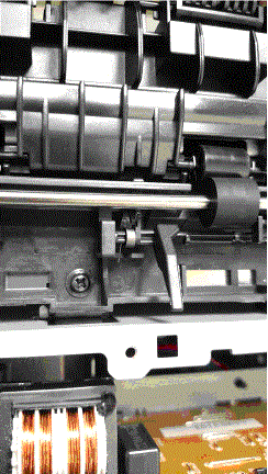

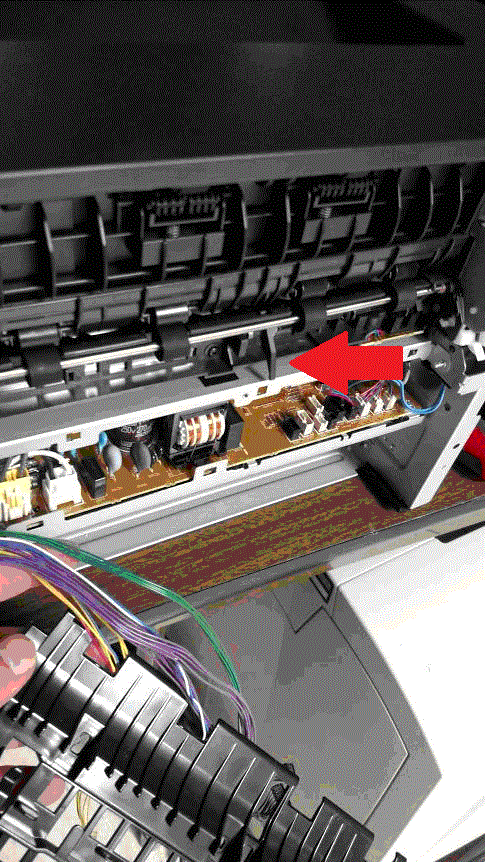

I tried the suggested spring tightening method and it did not resolve the issue I was having with the M401 Constantly jamming. I have to disagree with the statement that it "isn't a problem with the cartridge area." It seems as though the toner cartridge is not moving at all. I have replaced the toner cartridge with a new "remanufactured" cartridge and it still does the same thing. I have also tried to install an OEM toner and that did not resolve the issue either. The machine jams right after registration and right before entering the toner cartridge. I have included images for the spring procedure that did not help. Flag location.gifsensorflag.gifI am still under the impression that this is a problem with the toner cartridge but have been unable to prove it.

Thank you Steelhorse, I appreciate your blind copy and paste of the previous post. If you even bothered to take the time to read my post, you would clearly be able to see that I removed the rear cover and double wound the spring. I also bothered to take photos of the sensor you are suggesting is "wound a little too loosely." It didn't fix a thing. The paper isn't passing through the toner cartridge, period. (At least in my case.) Clearly indicating that this would more that likely be an issue with the cartridge or the cartridge motor/gears. But hey, thanks again for reposting.
