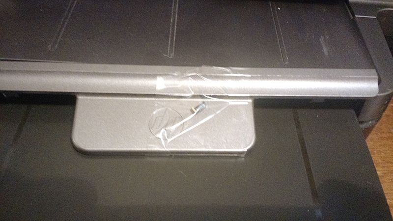

Hi.  I hope someone who can help me to find the replacement for the Flap from the output tray for HP Officejet Pro 8600 N911a printer.   I just found out that my warranty just expired on June 22, 2014 without informing me that is expired (I was very dissappoint) and will buy extended warranty after I find the replacement.  My flap from the output extentsion tray broke it off and now I cannot use the extention tray.  I wonder if there is a replacement for it.  I just bought this printer two years ago.  Can anybody please help me to find the replacement?  Is there?  Thank you.

Hi.  What's about me?  I am still looking for flap thing for extanded legal paper.  Can anybody help me to find replacement Flap thing (pictures at the bottom)?  I still looking for it.  Please...  Thank you...
Well, Im having the same problem, but I live in Mexico City. So we all agree  the part number you supplied IS INCORRECT (CM749-60036) THATS THE MAIN PAPER TRAY. What we all are looking for is the EXPANDABLE TRAY THAT HOLDS THE PRINTED SHEETS, because its very hard to take it out for full legal size to lay on it, and the plastic hinges that move the lever on Susan Grayson picture are EXTREMELY delicate, so yes, they broke. I have one just like Susan and the other officejet 8600 owners do. So, maybe is the OUTPUT TRAY, because as I see it, that expandable tray is part of a whole upper piece that creates the idea of a sheet drawder, along with the flap, which all of us have laying down somewhere waiting to be replaced.
The flap itself has a MODEL NUMBER ON IT: CM750-40054.

That thing in the picture placed with tape and marked inside the red lines in my second picture, is the fragile hinge which makes the flap move and breaks after trying to get the full expandable tray out, which is very tight. Thats what makes us having to look for a replacement part.flap and broken hingeactual flap and broken hinge 2
