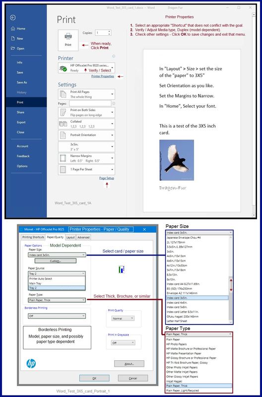

Document and Print
Open Word
Set Layout > Paper / Page size = 4x6 inches
Orientation = Portrait
Margins = Narrow
Create and save content
Word > File > Print
Open Printer Properties > Select a Shortcut - if none close to what you want, select "Everyday Printing" and make changes.
Select / verify paper type as Brochure, Index, "thick paper" as available - NOT Photo paper
Set Duplex OFF
Set Borderless OFF
Click OK to save changes and leave the Printer Properties menu
Example - Word > File > Print - 3x5 inch Index document - Portrait
Word_Test_3X5_card_Portrait_1Word_Test_3X5_card_Portrait_1

Document and Print
Open Word
Margins = Narrow
Word > File > Print
Set Duplex OFF
Set Borderless OFF
