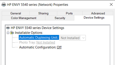

I'm another one with this problem, but so far all of the solutions posted here and at Microsoft have failed for me. I bought this printer specifically because of duplex printing, and 5 months ago it stopped; the printer hadn't even reached two years old [for me] at the time. What happened around that time: my Win8.1 computer died a sudden death. I was gifted a brand new Chromebook and set up the printer with no problem as far as wireless went. I did not need duplex printing at that time. And then I was gifted a new HP laptop with Win10 Home. I set the laptop up on March 9th, and it was then I noticed I no longer had duplex printing. Started scouring the internet for fixes. Can't begin to tell you how many times I have deleted all software fro the printer, totally unplugged the printer [cord from wall and printer], prayed over it, cussed at it, and found a partial work around using Foxit Reader which DOES send a signal to print the document [saved as a PDF] in duplex, but that isn't always convenient. I am skeptical over one suggestion that the duplex module has died and isn't fixable.

Hi,
Make sure the Automatic Duplexing option is enabled:
Enter Control Panel > Devices and Printers.
Right click the printer icon, then click Printer Properties.
Click the Device Settings tab.
Set the Automatic Two-Sided Duplex Accessory as installed and click OK to save the change.
Now Automatic Duplexing should become available.

Thank you for answering, however, I have done that more times than I can count. It says it's installed, but I'm stuck with manual flip, and the duplex module goes back to being uninstalled. The ONLY time, as I have stated, that I can get a double-sided print is if I save a document as a PDF and print it from Foxit Reader. That's the work around, but if I can make that work [there is an option for two-sided printing in Foxit printer command] it should work in any other program. I can't afford Word so I use Libre Office Writer. When I hit Print and the command comes up I check to see if I can duplex, but I'm stuck with manual flip, and indeed only one side will print and I would have to manually flip the page to print the other side. Print from a web page produces the same thing - manually flip.
So, no matter how many times I click on Automatic Configuration and turn it ON showing that Automatic Duplexing is installed, the Printer Preferences still say Manual flip. 😭

SholmiL, as I started to follow your directions, I decided to check through Device settings one more time when I noticed under the Advanced tab under Properties something that had not been there before: Driver: HP Envy 5540 Series ---> New Driver. I had thought like you that the problem might be a corrupted printer driver and I had looked numerous times in Device settings for a way to check/install a new one, but despite going through all the tabs, nothing ever showed up - until today.
Going through the new driver wizard it came up with two drivers for the same date in Feb. 2017 but different versions. I selected the first one which was older than the second one. It quickly installed and voilà! I have my duplex printing back! I have no clue why the New Driver choice had not been there before, but was excited to see it was there and that I was able to get my settings back!
