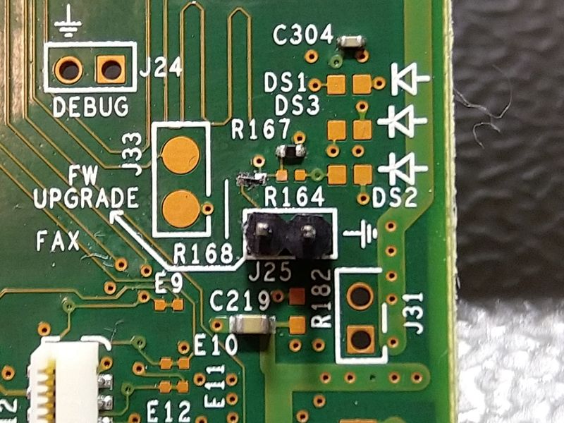

@Incith - I can give it another try tomorrow, but it didn't work for me when I shorted FW_Upgrade on my Rev B board. I even used a physical jumper so I'm certain those pins were shorted on power-on.
If DS2 is just an LED, then it's probably not needed (sorry, vision is terrible - it looked like it might be a cap when I first looked at it.)

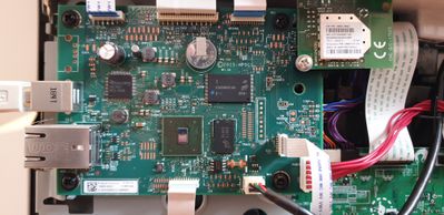

Just tried it again. It doesn't work with my Rev. B formatter board. As you can see, the board is physically jumpered from the picture, and it's still bringing up the 49 service error. I even re-examined my header soldering under a magnifier, and it's perfect.
Yes - that model
If your board did not have the pin header and resistors soldered in place you need to short the pads the arrows are pointing at.
The resistor needs to get bypassed, by either shorting directly to the pads marked with arrows or by solder on a resistor (probably a 0 ohm is populated) or a small wire.  and then you short the pin header.
This is how I made it while trying to fix it. as you can see I solder a piece of wire on R168.firmware_upgrade_pads.jpg

I have shorten the Connectors with a Paperclip and turn the Printer on.
After 3 Seconds you hear the Bing on the Computer, connecting to USB.
But I also have to send then ENG version from the above Link.
THX a lot!
