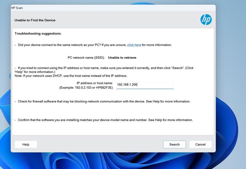

Thank you for the instructions.  As I type this, I am not able to get past Part A, Step 6. In the installation, the dialog box asks me for the IP address. I give what I think is the IP address, and I receive this dialog box:
I tried again (still stuck on Part A, Step 6), and got this:HPTroubleshooting20Apr2024DF.jpg
Still stuck on Part A, Step 6. I tried to connect the computer and printer with a USB cable. The dialog box thinks I did not connect them.
Hi,
Thanks for your feedback with the screenshots.
The error is not with the installation itself, but the printer must be reset and the WLAN, WiFi must be deactivated. Also, the printer must not be connected to the system!
