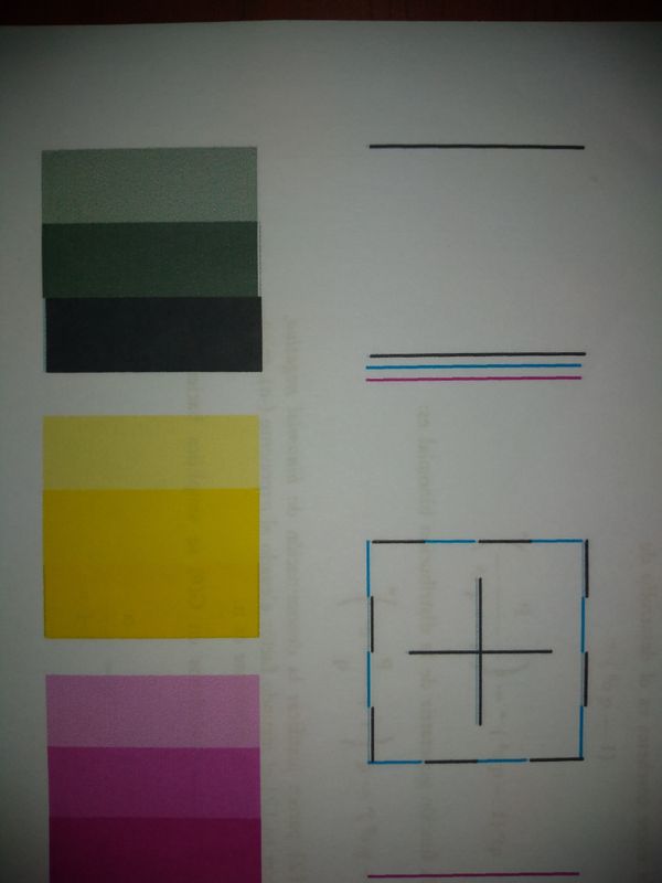

Hello, I am writing to you because I have a problem and searching everywhere I cannot find a solution. I recently bought for the first time an XL color cartridge for my deskjet 1015 printer, I have already bought a black one and everything was ok. But with this new color cartridge, although it was detected correctly, the printing between colors and black ink are unaligned, and I have run the alignment utility several times, with no results.
I would greatly appreciate if someone can help me on this problem. I know it is a cheap and old printer, but because of my professional background and my environmental ethics, I refuse to discard it until I am convinced that there is no hope.
Thanks in advance for your help.
Best regards,
Ximena

Hello Sandytechy20,
thanks for your help, but unfortunately your instructions didn´t solve the problem; because it has nothing to do with the quality of the printing or how clean or dirt are the ink nozzles, but more with the alignment of the printing heads.
No matter how much I clean those cartridges, the alignment is still bad. I have run several alignment tests, and the color inks are still printing unaligned respect with the black ink. I am attaching one picture to try to illustrate the problem, you can see that printing is good, lines and areas are well covered in ink, but there is a notorious unaligment between colors and black.
Apparently I am the only one who has this problem, I haven´t seen or found another similar topic, and there is no suggestion to what to do in this case.
Thanks anyway for your help, but if you don´t have another idea thay may help, I think this problem is hopeless.
Best regards.
@Atomic_Cat
This looks like a hardware issue.
I request you to talk to HP support.
They might have multiple options to help you with this.
