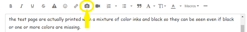

You can attach a picture here by clicking on the camera icon just above the text entry box.
