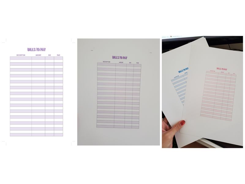

So I ran into this problem with my printer where it prints well, except sometimes it just won't print certain parts of my pages. For example:
1) I had a page smaller than letter page and had crop marks for when I do print it on letter I know where to cut. It only printed partially of the top crop marks and none of  the others. Not on the bottom of the page, not on the back sides and not on any of my other pages. Anything else on the page it printed just fine. I added an image of my digital file where it shows the crop marks and pictures of what came out of my printer. This was printed in full color, high quality.printexample.jpg
2) If I print a full page, it's great quality, except the last 5CM or so on the page is bad quality. Printed in full color, high quality, the top and middle part of the page look amazing, the bottom looks like draft print.
3) If I print text (I think usually in black) on the bottom of the page it just wont do certain parts of it.
EDIT:
4) I just found this in my planner as well, even in the middle of the page it just seems to give up on black for some reason while the rest around is also fully printed. Again this was printed in full color, high quality setting.
If anyone knows what's going on and how I can fix this, I appreciate any advice!

Did you make a copy and  check if that copies fine?
