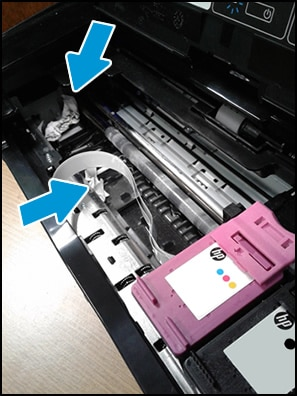

  • Look in the carriage path for debris such as crumpled paper or dislodged labels, and then remove any that you find.
Example of a printer with debris in the carriage path
View inside a printer showing crumpled paper in the carriage path causing a carriage jam
