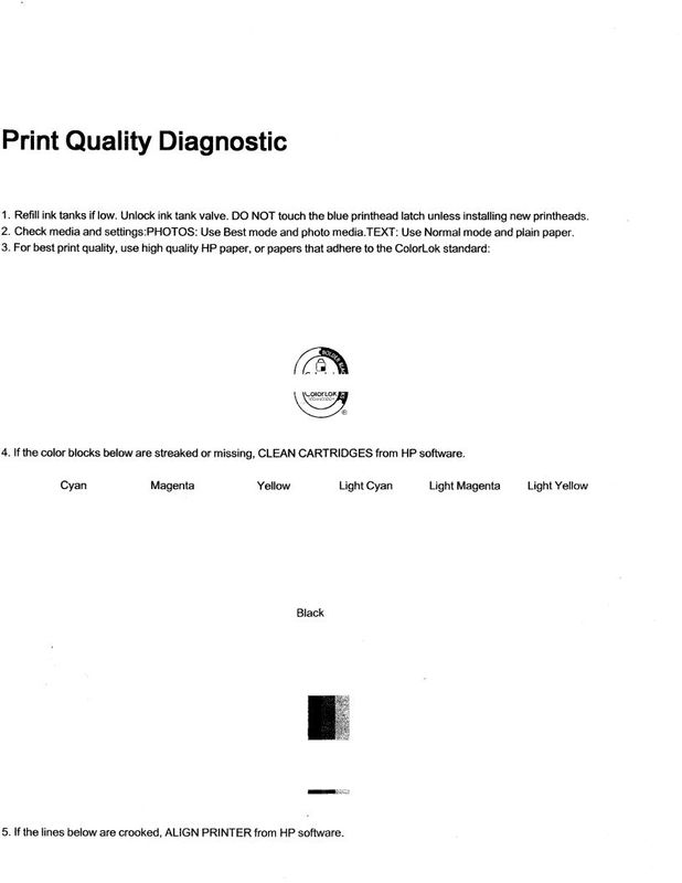

Printer error pagesjpg_Page1.jpgPrinter error pagesjpg_Page2.jpgPrinter error pagesjpg_Page3.jpg
Thanks for your detailed reply. I did all the things you suggested, but... I attached some of the printing. It seems like the top margin is too large, so it prints off the end of the page.
The print also seems to be good for about a third of a page, then starts to print over itself.
I tried  to add a video of it trying to print the test page but it gives a circle with a strike thru on the "Insert Video" button.
The test page only prints part of the top logo and then just goes back and forth.
It cannot print an alignment page. The error is 3221225477 (0xC000005) and the toolbox stops working and shuts down.
