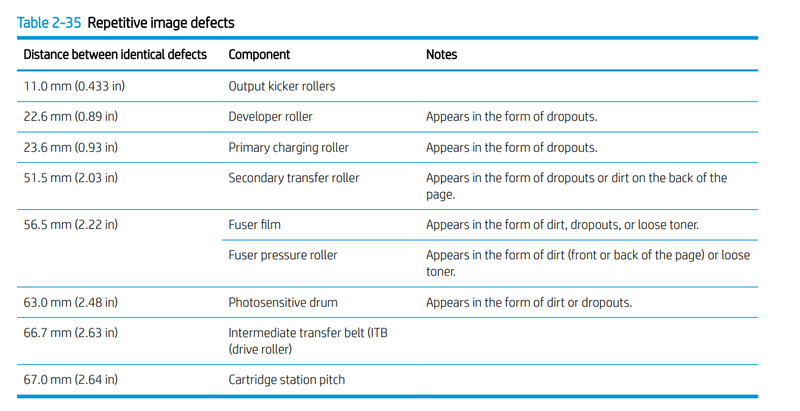

Measure the distance between the repetitive defects and use that measurement with the chart below to determine what component is causing the problem

Hi Repairatrooper,
Thanks! I actually saw that image prior to my post, and since the distance of the repetetive pattern on my prints far exceeds even the last line of the table, it didn't help much I'm afraid.
The ghost image starts approximately 190 mm/7,5 inch down the page.
