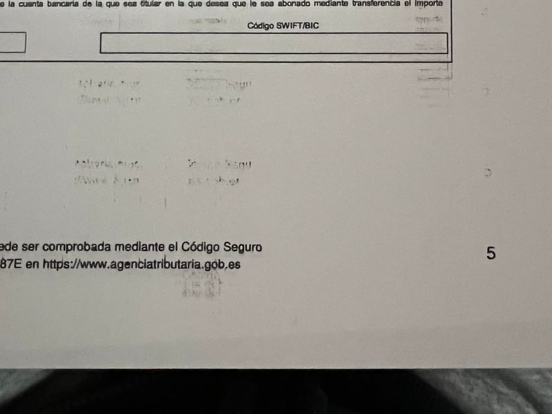

I've just bought this printer and I noticed that when printing doubled sided, the first side of each page is blurred and ghosted and the back side is perfect.
I think it happens when the printer eats the paper and it slide the ink.
I tried with more dry time but it didn't work. I also tried in Windows 10, 11, copying from ADF, and it always happens.
Is it related with the out of the box cartridges or is a known problem of this printer?
Thank you in advanced.

I don’t know which kind of paper it is. I know it is A4 80gr.
I’ll buy paper for inkjet and try.
Some low-quality papers might cause problems like yours.
My profile on LinkedIn
It was the paper... I have never had this problem before.
Thank you a lot!
