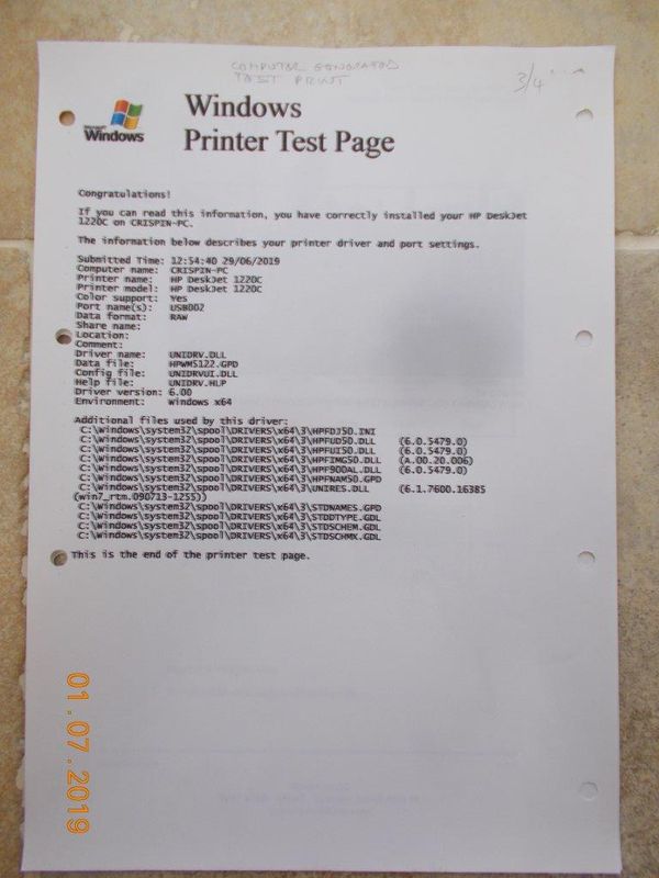

07-01-2019 07:40 AM
Thank you Bob.
The problem does seem to be with a double pass of the black print head. A calibration page test print carried out as you describe produces a perfect print. I have tried cleaning the automatic alignment sensor but this has not helped.
Attached are a series of test prints.
1-4 Printer generated – perfect
2-4 Printer generated – perfect
3-4 Standard Computer generated test print – colour printing perfect, black shows shadowing
4-4 Computer generated print from the HP1220C Service Manual. Colours and grey – perfect, black shows shadowing.
Can you offer any further advice?
07-10-2019 11:34 AM
[Sorry for the delay, I missed this one.] Based on the picture 2/4 it appears the black and color are very misaligned, perhaps outside the printer's ability to automatically correct. I would suggest removing the black cartridge and inspecting the carriage. On the right side of the slot for the black cartridge is a spring that holds the cartridge tightly against the left side of the cartridge holder. Make sure the spring is in place. (The spring is a wide flat bit of stainless steel.) Make sure that the black cartridge does not have any damaged plastic on the left side, and no obstructions such as tape or labels applied. Also, check the color side and make sure it is seated properly as well.
