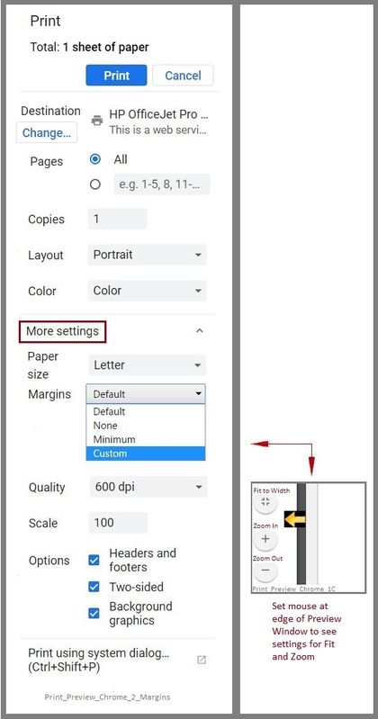

IF you are using the Chrome browser to print, the following might apply (or at least give you a place to check / start):
Chrome > Settings > Print > More Settings
  • If margins are left at Default, the print may start 2 inches from the top of the paper >> check!
  • If needful, adjust your margins and / or settings to Fit-to-Width
  • Switch on / off printing of Headers and Footers
  • Depending on your version of Chrome / OS, access Chrome Settings
  • Page Range is controlled in "Print using system dialog..."
Download, Install, Open Chrome > Look for Settings icon:
Three vertical dots – upper right corner of Chrome window:
Place mouse at the right side of the Preview window to see settings for Fit width and Zoom in / out
Print_Preview_Chrome_2_MarginsPrint_Preview_Chrome_2_Margins
