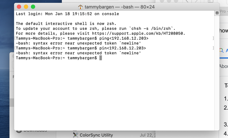

this was the results of the ping test (if i did it correctly)
