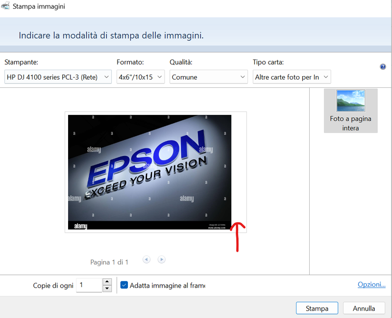

i have an issue to print 10x15 photo.
i would like to print , by all software, an image on 10x15 paper but i have two issues.
1) i cannot remote the margin
2) the margin on the right is bigger than left margin (1cm) , i seems that the print page size is more little than the paper
i try to remove the driver and re-install but nothing...the issue is still ... how can i to solve?
Thanks to everybody

Hi,
thanks a lot for your response.
I agree with you about A4, but i have a lot of difficult to have a good solution for 15x10 format.
always when i print the photo on 15x10 format i have the same margin , like A4.
i think it's not usefull to keep this margin.
is there a way to have the same margin on 15x10 format?
Thanks for your help

OK - Windows.
The print apps and print software options are good in Windows --
That said...
Nothing helps that required 12.7mm (1/2 inch) margin disappear.
Why?  DeskJet Printer wants that bottom margin larger.
Rotate the image to print in Landscape and the margin moves to the side.
Print Pictures limits Options > Printer Properties to those the printer supports.
If you want to (or must) use Print Pictures
If you want the image to print at 4x6,
Try using full size paper (A4) - and set the paper size in Print Pictures to A4, too.
Set "Copies of each picture" to 1 (one)
On the right side, select 10x15 / 4x6 inch (second choice from top / full size photo).
Print the photo and cut out the printed image.
Simple Example - Print Pictures - Full Size Paper and one 4x6 inch photo (10x15 cm)
HP Smart - Windows can print the image in 10X15 / 4x6 inch on larger paper.
Do that and then cut out the image.
