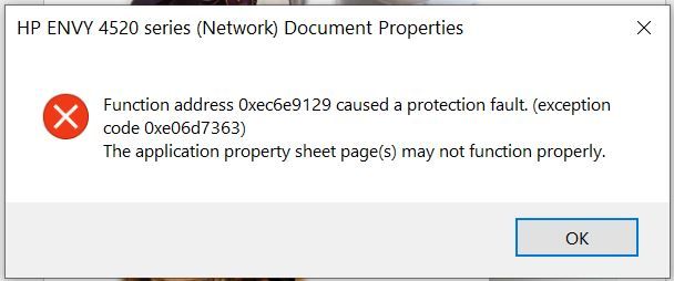

I managed to repeat the problem that may have caused my printing issues by choosing draft printing quality via MS Word again and the next time I clicked on printer properties to go back to normal quality, also via Word I got the error message back up if it means anything to anyone?
Thank you,
