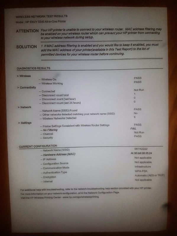

The software basically refers me back to the 'printers setup wizard' to initially to connect to the router. Obviously, this then takes me round in circles again with the 'Mac filtering error'This is the diagnostic printout after printer/wifi errorThis is the diagnostic printout after printer/wifi errorJust for reference:Software troubleshoot screenshotJust for reference:Software troubleshoot screenshot
I've added a couple of pictures/screenshots - Maybe there is something simple i'm missing here..

As asked - Restored back to factory plus restored the Network default, disabled the IPv6 as requested, disabled all security and made connection open - Still no luck, giving me the mac filtering error in the diagnostic print out.
Understand your concern about it not connecting to the open connection, However, as mentioned - It will find a hotspot generated by my phone, pass the security and connect.
