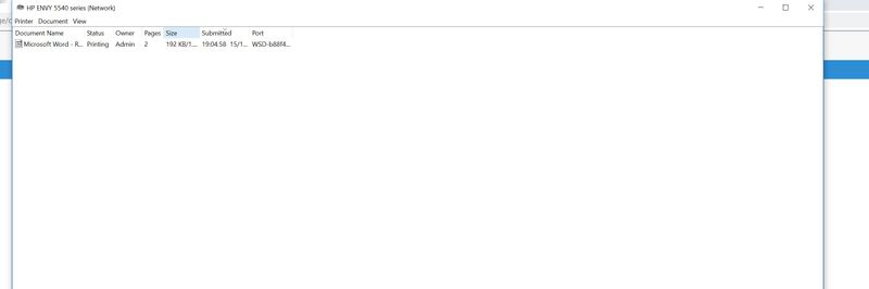

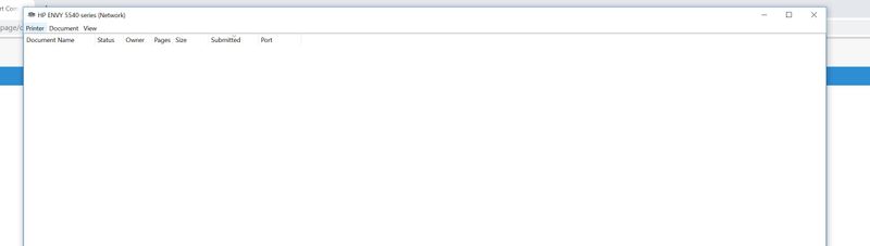

The printer is recoginsed by Windows as my default after it's installed. I can print test pages. BUT when I print from software such as Word or Adobe, at first the job appears in the print list and then after a few seconds it just disappears (see pictures below). As mentioned, uninstalling and reinstalling software and drivers hasn't helped and the printer itself works from my phone. But what I need to print urgently isn't transferable! Seriously, it's reached the point whereby I am close to throwing the printer in the bin and writing off the money I've wasted on ink and specialist paper. Very very disapointed.
