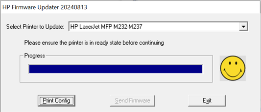

      Despite this, any attempt to update the firmware manually does not restore functionality, even though the firmware update utility indicates success (showing a yellow smiling face):
