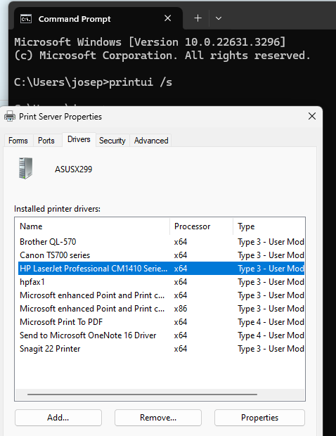

Try uninstalling and re-installing the windows 11 driver.  Here is the uninstall proceedure:
Run the following app from the command line
printui /s
Remove all references to the HP printer.
Install the new driver and then search for the printer.  I think you have the m234sdwe and not the 324
