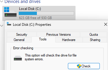

When was the last time you ran the windows scan disk?
You might want to check for any problems in the disk drive
