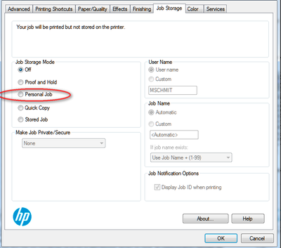

Another Issue is that whenever a stored print job is printed it will remain in job storage. Is there any way to auto-delete printed jobs?

Did the printer print in color before you started using pins? If not it is possible that when installed, the fact that the printer was color may not have set and you will need to check the driver to ensure that under installable options the device type is either auto or color. As for the jobs not being deleted, likely you have the users selecting the wrong storage option. Correct option is personal job if they want to print once and have it deleted. You can also configure the printer to purge jobs automatically after X number of days.

So personal job right? I think I  set up with stored job. I'll check that one.

As for jobs not being deleted after printing I followed suggestion above and switched "stored job" to "personal job" in printer preferences.
