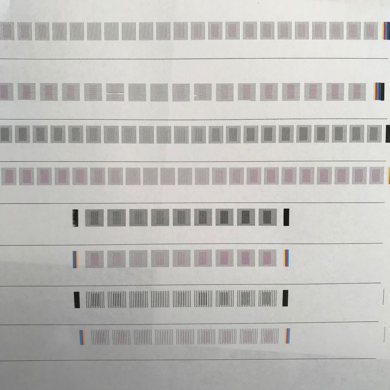

I have an HP Officejet 100 Mobile Printer.
The output has horizontal gaps (see attached photos).
I am running OS X 10.11.6, I have HP Utility 5.37.1 (1789)
I've powered off the printer and also done a factory reset.
I've tried cleaning the printer heads several times, however, it still outputs prints horizitonal banding gaps.
The HP Utility app fails when I try to initiate a level two cleaning.
The HP utility app. allows me to initiate a head alignment,  it prints an alignment page but then never
asks me any questions about the output.IMG_9158.jpgIMG_9157.jpgIMG_9156.jpgIMG_9155.jpgScreen Shot 2019-04-11 at 10.55.14 AM.png

Replace black ink cartridge and print will be fine.
My profile on LinkedIn
The black ink cartridge is only 2-3 months old.
Do you think that it's bad?
1. Why doesn't the HP Print Utility allow me to initiate level 2 printer head cleaning?
2. Why doesn't the HP Print Utility walk me throught the Q+A on printer head alignment.
Something else must be wrong with the printer.
It's black ink cartridge, replace it and you should be fine.
I changed the font color of my test print file to blue and it printed without any horizontal bands.
This supports your hypothesis.
Thank You!  Replacing the black in cartridge solve the printing problem.
