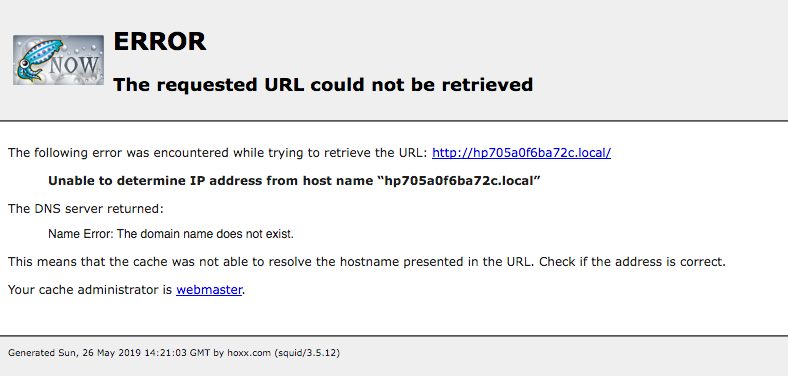

I attempted updating the printer firmware using the printer control panel display. This was the result:

Sorry for the time lag - first a move, then no internet connection for a month, then the update to 10.13.6 resulted in no printer connection, and no Bonjour. With no Bonjour the EasyStart wouldn't work. Reset the printer to factory default. Downloaded and installed an old Mavericks driver which gave me Bonjour. Then EasyStart would work. Updated drivers. I then set the manual ip, and set the DNS to 1.1.1.1. and 1.0.0.1. which has the benefits of giving no information to Google, and (due to the lighter workload) is faster.
Successfully ran the firmware updater (after manually entering the ip) and received the negative message that meant that the firmware I had was the newest version.
