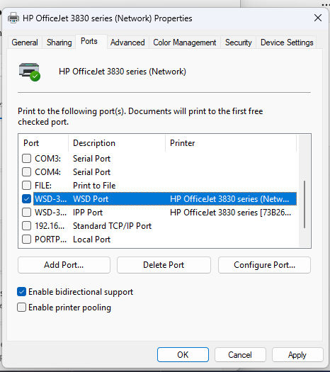

Actually it's worse.  One T490 prints okay and the other does not. They both use same bios and settings are identical. Printing from android Tablet is  also fine. Printer has static IP ( I set it outside of my router DHCP range).
I tried a WIFI usb dongle same result.  I also have  a Toshiba laptop  (installed as WSD) on 2.4 G which works fine printing. The problematic T490 always seems to install as WSD  (cannot get it to install in other way).
I tried again removing HPsmart app from host machine and  installing the Hp smart app on a Vmware virtual machine win 11. In bridged network mode.
Same printing issue.
Hopefully the final solution >
After comparing both T490s again , the bios, printing preferences were the same. The only difference was that I couldn't understand was on the troublesome
  T490, the printer would always install as WSD ( see image) WSD not printing.pngwhile the "good"  T490 was on TCP/IP . At first that did not bother me because I also have a Toshiba using WSD which works fine printing. But that always bothered me ( that initial hunch would prove correct).
  Well, I should have addressed that issue way back at the beginning. Luckily in printer properties under Ports tab, there was an unchecked entry for TCP/IP.
  I checked that instead (see image) TCIP printing.png. And it now  prints with only one cartridge installed. Seems as though the WSD option did not quite work as expected (needing both cartridges installed).
  They say that Lenovo computers usually default to WSD which sometimes can cause issues. Why  each T490 defaulted to different setups, is another story I am not going to dig into.
And that resolves the issue. Long journey. Appreciate your hand-holding throught the troubleshooting process.
