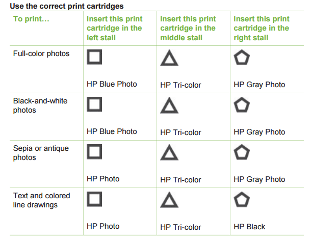

The Photosmart 8750 is beyond the official support life and most of the documents have been removed from the HP site.  I did find the user manual on the HP site here (recommend saving it before it goes away) and it does list the optimum cartridge configurations on page 13:
