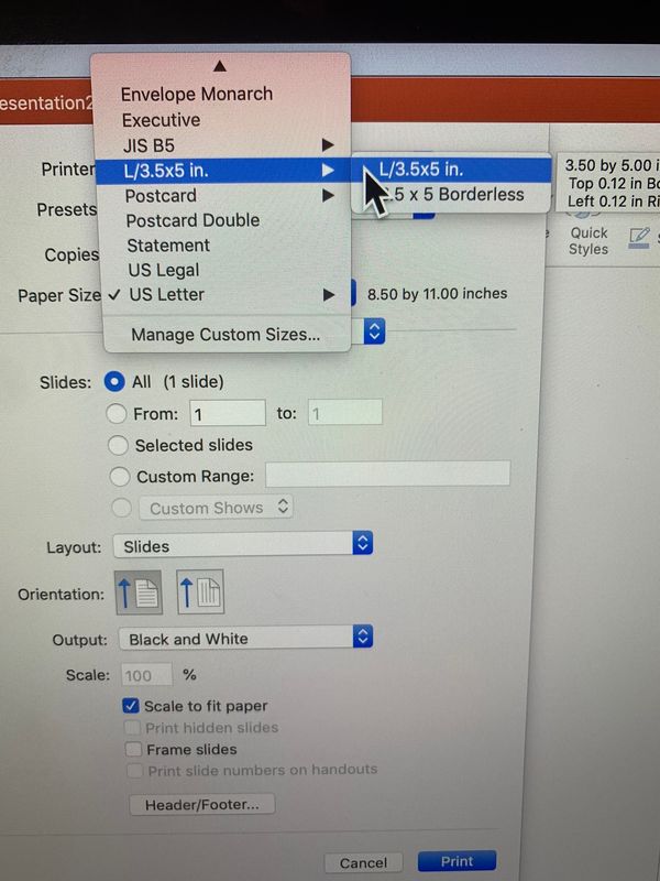

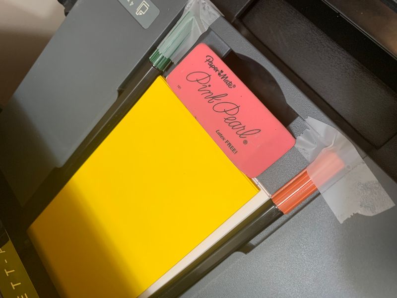

This looks dumb but it worked! I used two pens (one on either side) and an eraser (front edge) to snuggly fit the index cards into the photo tray.  I designed cards in PowerPoint and used paper size L3.5x5.

This machine does not take 3x5 cards.  The menu says it does, because HP put the same menu software onto this machine that it put on machines that do take 3x5 cards.  That's why the Best Buy salesman, not knowing any better, told me the machine would do 3x5 cards.   Someone recently posted something about using erasers as shims around 3x5 cards in the 4x6 photo tray to hold them securely, and then making sure that whatever word processor you're using mapped out the appropriate 3x5 print area on the 4x6 paper size on your computer screen.  I don't know if that would work or not, or if the paper handling arms of the printer are wider than 3" so that they would not grip the cards coming thru.   Bottom line:  HP not only messed up in putting misleading information on the media list in the menu to save a buck but further messed up in not posting a clear concise explanation of the problem on this bulletin board.  Half the HP tech reps I talked to when I was originally trying to figure out what the problem was didn't know the answer themselves.  HP, like many a corporation, is not about proactive customer service.
