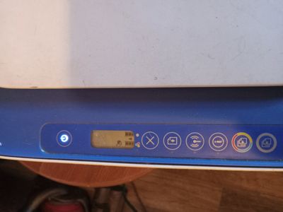

- Hp deskjet 2623 errer code e3 two blinking lights

I understand that you are facing issues with E3 which is a carriage Jam.
Perform the following tasks in the order given. Use the printer after each task to see if the issue is resolved.
Check for obstructions in the carriage path
- Remove any loose paper or obstructions that might be blocking the carriage path.
- If the Cancel button
on the control panel is lit, press it and wait until the printer is silent.
- Turn off the printer, and then disconnect the power cord.
- Open the cartridge access door to get to the carriage inside the printer.
- EXAMPLES OF A CARTRIDGE ACCESS DOOR
- Make sure the carriage is not obstructed by gently sliding the carriage side to side.
- Look for and remove any obstructions in the carriage path, such as crumpled paper or dislodged labels.
- CAUTION:
- Do not tilt an ink tank printer when attempting to remove obstructions as ink might spill.
- EXAMPLE OF A PRINTER WITH AN OBSTRUCTION IN THE CARRIAGE PATH
- If the carriage has a latch, gently press it down to make sure it is locked into place.
- CAUTION:
- If the carriage latch of an ink tank printer is secured, do not press down on it to avoid printer damage.
- EXAMPLES OF THE CARRIAGE LATCH
- If the carriage is not locked in place, move it to each side, removing any obstructions blocking its path.
- CAUTION:
- Do not force the carriage to move if it is locked or stuck. This can damage the printer.
- Close the printer door.
- Reconnect the power cord, and then turn on the printer.
Click here for the remaining steps.
