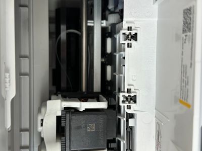

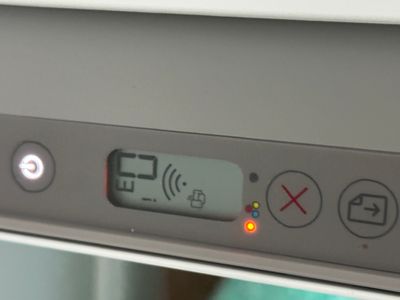

Hello everyone, my printer deskjet 2855e is having a problem, it's keeps flashing e0 and not working. I just printed something on it a week ago and it worked fine. This printer is also only 2 months old. Not sure what the problem is, I tried resetting and it didn't help. I just opened up the ink cartridge and noticed there is a white paper strip that seems to be standing up kind of high behind the cartridges, I'm not sure if this is normal or not. Please help, thank you!

  • Open the cartridge access area and check for any paper jams or foreign objects, including the white paper strip you mentioned. If it's not part of the design, carefully remove it without damaging any components.
