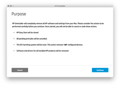

2. Open HP Easy Start and Select the HP Easy Start Menu in the macOS menu bar.  In this menu select Uninstall HP Software.
3.Select Continue to start the Uninstall process

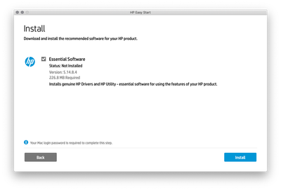

6. This will lead to the software download/install prompt.
7. Select install and the remaining prompts to finish the process.
