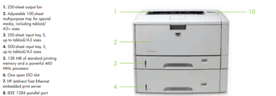

HP LaserJet 5200tn
Tray 1: Letter
Tray 2: 11x17
Error: 13.01.00 Jam In Tray 2
The Properties Preferences are already set up in Windows 10. In the printer menu, Tray 2 is set to print with 11x17.
Most times when I send an 11"x17" print, it says "Load Tray 2, Bond 11x17" and the Attention light will be flashing. If I hit the Select button, it would ask to verify it is the Tray 2 with 11x17, then I hit the Select button again, then, the printer will pick up the paper in Tray 2 and prints. On this note, I don't think it is the Tray 2 roller.
I have double checked the tray to make sure all the guards are well sited. I acts like a sensor issue; since the roller picks up the paper.
Once in a while, I get the error13.01.00, even though there is not paper jam.
Cheers and wishing you all a wonderful new year!
