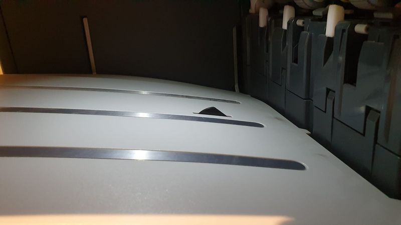

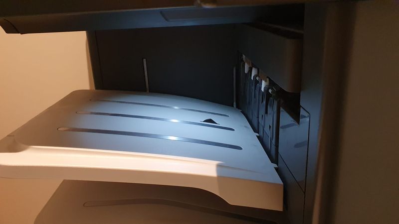

I have taken a direct look at the printing process myself. The printer starts printing, the paper is fed correctly and exits through the correct opening. The error appears as soon as the paper falls down and pushes a black mechanical plastic part down.
Here are the photos of the aforementioned black mechanical part :
Tiny mechanical trigger that triggers error on screen.Tiny mechanical trigger that triggers error on screen.Tiny mechanical trigger that triggers error on screen.Tiny mechanical trigger that triggers error on screen.

You likely have a sensor error, but not that one on the tray. Your will need to go into the troubleshooting menu and check the manual sensor test to see if a sensor is always tripped. Do you get the error regardless of the output you have selected? If yes check the output sensor for the standard output bin as there is where that sensor is located.
