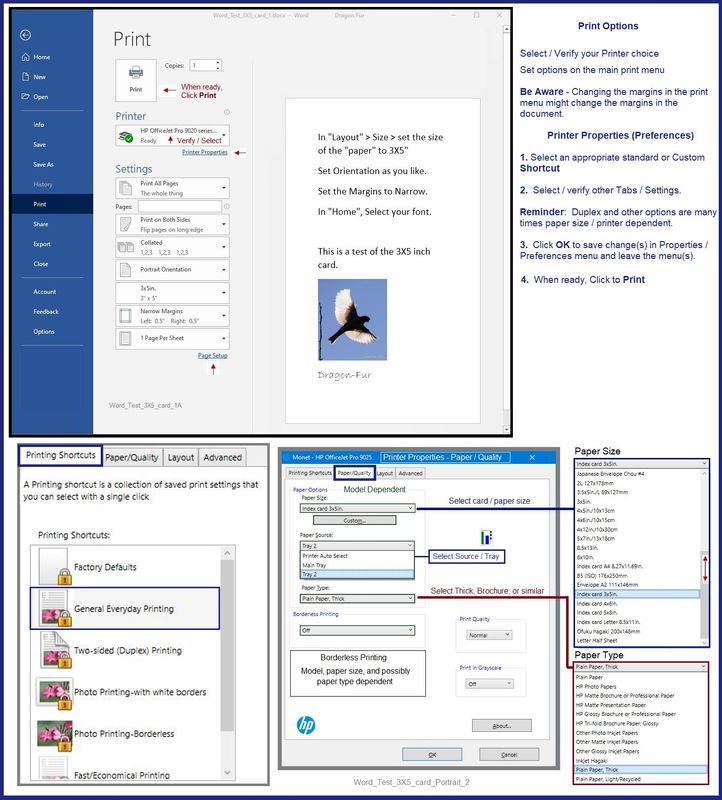

The following works on much newer Word, much different printer, and a decent network...
Word_Test_3X5_card_Portrait_2Word_Test_3X5_card_Portrait_2
