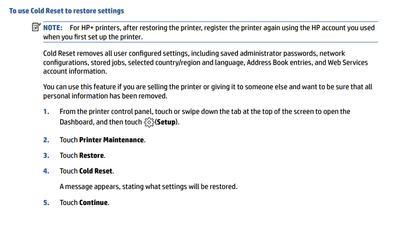

If the aforementioned power reset didn't work, I found the following "cold reset" procedure on p. 183 "Restore original factory defaults and settings" in the manual (see: http://h10032.www1.hp.com/ctg/Manual/c06940372.pdf) :
Disclaimer: performing any kind of "reset" may result in complications or even "bricking" the device.  If you are not comfortable performing said resets, reaching out to a professional technician is the best course of action.
