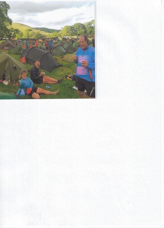

The one I mentioned was a PDF file. I've now snipped a photo from Facebook and it prints with a big pink rectangle on the front of someone wearing what shouds only be a blue jacket.

I can understand why green would be yellow if blue wasn't working, but not why blue would be pink (see file) and why it is  only certain areas . Why would it not happen with print Test Page in Printer Maintenance, but does with Print Quality Report?
An unrelated question in Settings- is there no way of turnign off Auto-off? I don't want the printer turning itself off.pink top.jpegbluetop.JPG
