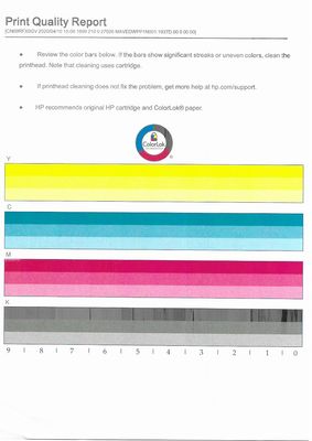

in the 2nd thread, user TheCabin329, mentions something that may be the key to the puzzle.  His problem occurred after installing the high capacity black cartridge.  This was my case as well.  I would also like to add that I replaced all of the cartridges at the same time, AND the 3 CMY colors all came from Malaysia, while the Black (K) came from Singapore.  They are from two different lots.  It may be that there is a problem with the chip, or that the large capacity has a bit of air.

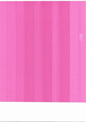

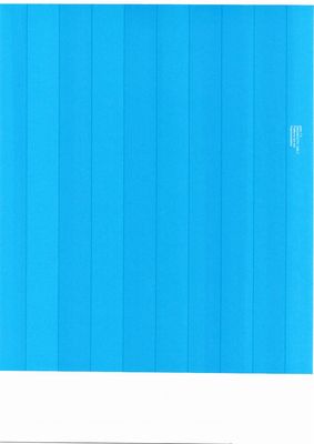

Below are a progression of Print quality reports... what's interesting is that the black was missing a bit, a cleaning, and it began to be grey.  Wiping the heads, and cleaning the duplex / waste ink tray; gave some temporary relief in that the black became more black.  Then, it finally came in mostly, and I started to print, after about 20 pages then, the black began to drop out completely; it finally reached the point where it just isn't there.
I am now returning the cartridges and will try to get all of them from Malaysia... I am actually a bit reluctant to get the high capacity.
