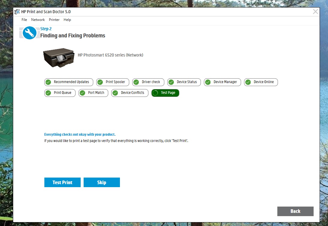

Hi Dvortex thanks again for your help, the HP Scan & Capture app worked fine but still have the problem of the Ink Levels not being shown. I ran the Print & Scan doctor after installing the Scan & Capture app but that is still the same but at least with the new app i can again scan to the computer thankyou, just need to sort the Ink Levels out and i will be a happy bunny.
