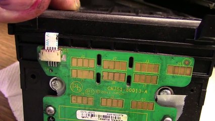

The printhead fix here worked for me https://www.dailymotion.com/video/x31gm35
