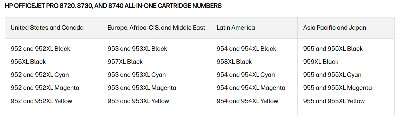

  1. Check cartridge compatibility.
    Remove one affected cartridge and verify the cartridge number matches your printer model and the country/region where the printer was purchased. HP notes that some cartridges can physically fit but are not compatible and can trigger communication errors.
  2. If the cartridge number does not match, use the correct cartridges.
    Use the cartridges that came with the printer or replace them with cartridges that match your printer model and country/region.
